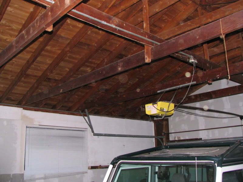

This is what the ceiling/roof in my garage looks like . The rest of the house is sheetrock attached under the joists and about 1 inch of cellulose and 4 inches of fiberglass. The Joists in the garage are on every 4th rafter.
I really like the look of the wood panelling above the rafters, thats why was wondering if I can use wood panelling over the rafters.
Correct, sorry, I was in a hurry. You know you have to leave the ceiling joists (rafter ties) every 4' alone, correct? Could you post another picture of the top of the valley rafter taken from under the garage door opener? It just doesn't look right at the tie-in of the ridge board.

What is the "top of the valley rafter"? Is that the spot on the Ridge beam that all the Rafters meet at? Will take a picture tomorrow.
This is another picture I took earlier.
