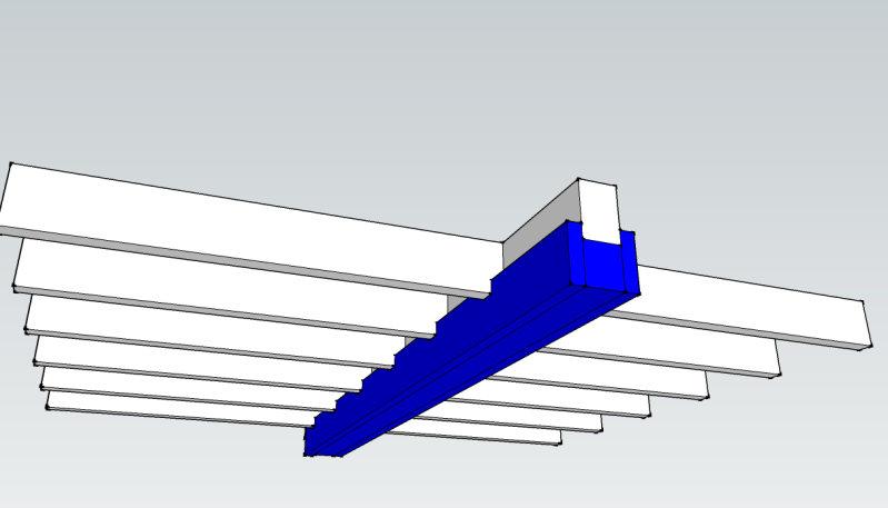

Here's a visual - not the most accurate but I hope it helps. (I used sketchup from google) - this is how I would do it if I were dealing with your situation. I am no pro - but at least in my area this solution would be up to code and is actually quite similar to what i've done on my house.
Here's your floor support - notice how your joists have notches cut out where they meet the center beam?
In those notches you can put in a new beam - one on each side of the center beam.
Between those two notches, where they extend down below the center beam, you should have room for a 4x4 beam.
Ok - so that's it for the center beam, it's basic - the ends of the beam will have no wood to attach to because it is in addition - no in replacement - of your current supports. You can use cement anchors (maybe) to attach it to the wall - or extend the outside surround beam down with a 2x10 added in . . . somewhat like in the next step:
Now - if you decide to do the joists, as well, rather than just try to firm up the center of the floor like you've been discussing, then this following stuff would need to be done first so you'll have adequate support for your center beam:
Here is your surround beams that are on the outside of your room (I'm imagining this is basically how it looks - simple)
So to install new joists you need to make the outside surround support adequate enough:
To do this - between each joist you should cut a 2x6, hammer it up into place and attach it to the old outside surround beam (it's called a girder, actually)
All new girder pieces should be the same depth as your new joists (if your new joists are 2x10 then your girders should be 2x10)
After you thicken up and fill in the girder you can then add in new joists. These, here, have a notch to sit on the new center beam and are nudged flush with the new outside girder.
I have imaged here 2x10's - they will run to the bottom of the new center which is the thickness of a 2x10, as well.
Remember- your ADDING to - not replacing - so all old pieces will stay where they are.
However, if you don't have enough room to maneuver a notched beam into place you fill in the notched area of the center beam with 2x4's - shown in orange:

Thanks SNAV,, for the pics, it all makes perfect since now after seeing pic's.-- im going to attempt adding support to center beam, and add the girders and leave in the old joist.- and in my sagging part im going to attempt to raise floor that is sagging near furness.- thanks alot.----NOW ? I got to convince the wife that doing this this spring is more important than adding a up stairs bathroom.- but she insisting on one, even with the cobbed up job someone did with plumbing in basement.- - should do all i said first.-- P.S. Not all the joist have the cut outs so the ones that dont i assume i just cut them into them.- thanks alot again
