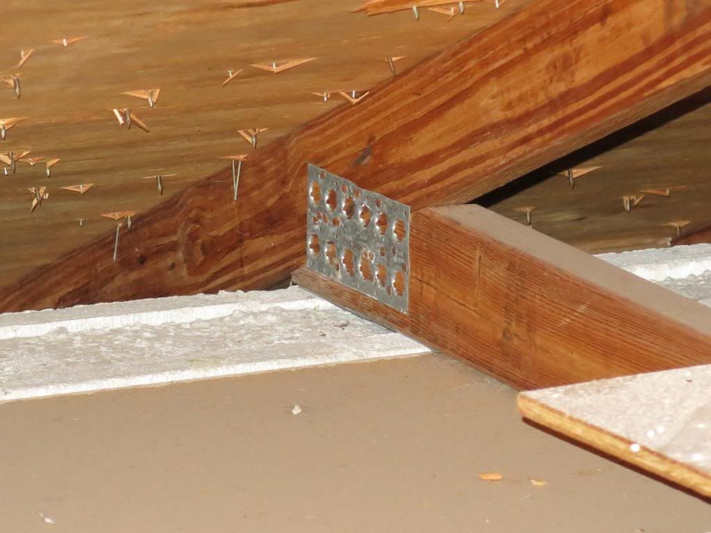

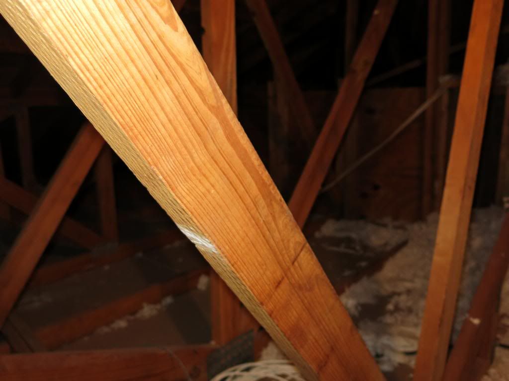

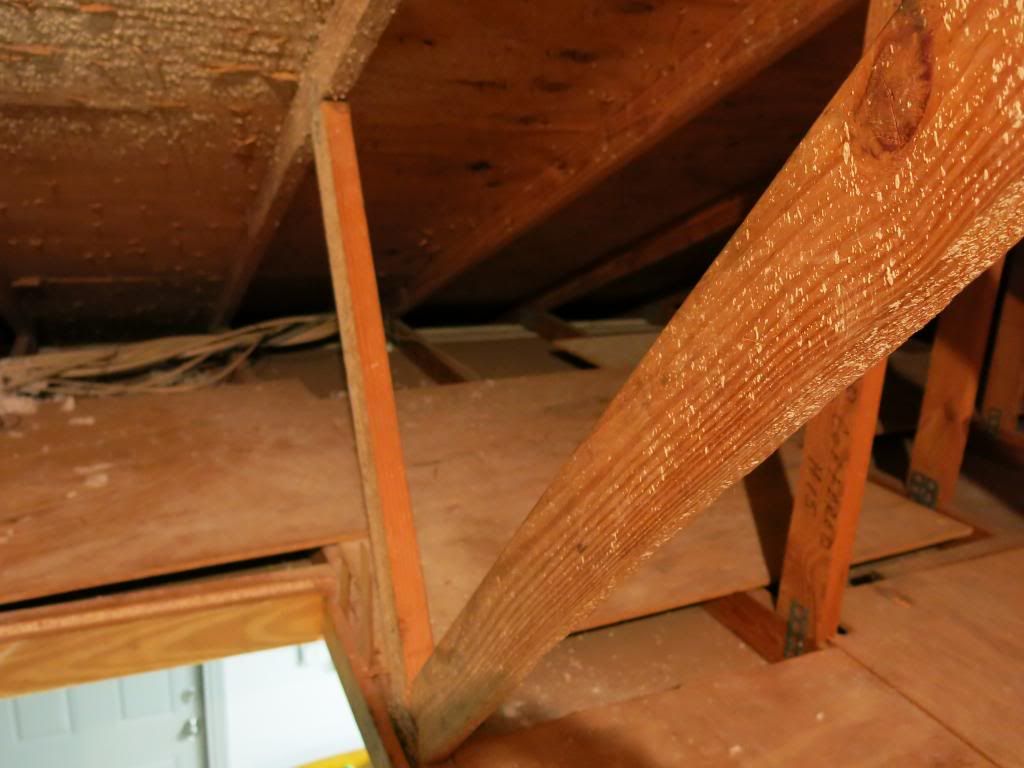

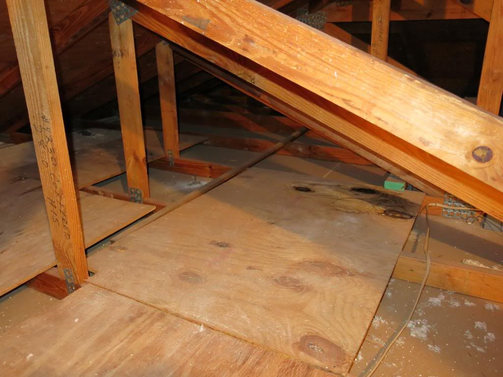

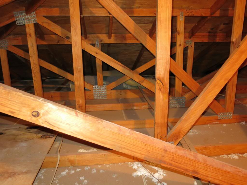

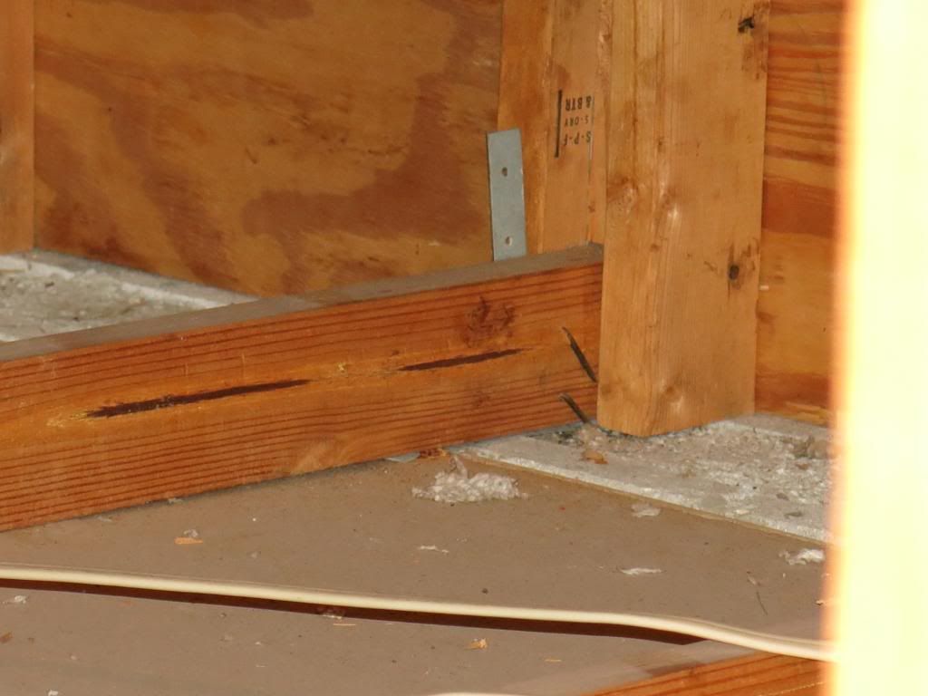

Some aren't nailed down and they've been placed haphazardly. Additionally I'd like to confirm it's safe to store up there and not just assume a previous DIYer put some stuff down and called it good.

Trusses are an engineered product and your trusses were likely designed to support drywall on the bottom chord. You will want to consult with the truss manufacturer or an engineer before loading the trusses with storage. If you do nail down plywood throughout the attic area use a nail gun as opposed to hand nailing. All that hammering near the connector plates can shake some loose, nail guns tend to cause less disturbance. Also, if the last owner cut a hole in the garage ceiling and put up the pull-down stair make sure he kept a fire separation between the garage and the living space. A pull down stair makes the space above the garage the same hazard as the garage. The typical required fire separation then would be between the garage attic and the living space. good luck with the new house.

Unfortunately many truss manufacturers do not mark their name on the trusses. The lumber grade should be stamped on the 2x4's, but not always the manufacturer name. Alpine http://www.alpeng.com/ is a large designer and manufacturer of trusses, it may be possible for them to analyze the loading capacity of your truss if you contact them. This service is not likely to be free, however it is likely to be less costly than hiring a structural engineer to evaluate your truss support capacity.
