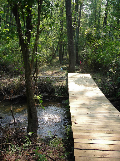

30' x 8' creek bridge
Here are two log bridges I built. No rails but I can get a small tractor across.
I have built a 55 foot one as well, no pictures but same construction. logs and decking.
