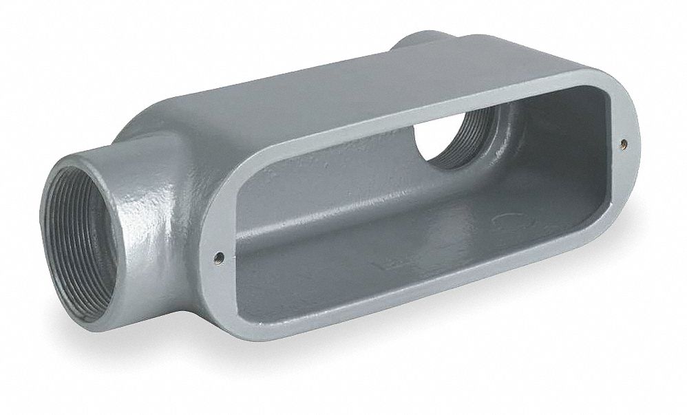

I would use a metal LB with a short nipple and locknuts, to come out the back of the panel. You can adjust the length of the nipple infinitely if you get all-thread by simply cutting it with a hacksaw. You can get all-thread up to 36".

If I were to go with all metal conduit out the side of the meter box via a male adapter, a short piece of pipe, a metal LB, and then threaded pipe in through the siding/sheathing into the back of the breaker panel and secure it with a locknut, what is the bonding requirement and what would be the recommended way to do it given that the meter box is already going to be bonded to two ground rods? Do I need a separate #4 AWG bare copper wire clamped to the metal conduit to bond it to the ground rods as well or since it will be all metal from the meter box (which is metal and bonded) through to the breaker panel (which has neutral bonded to ground) is there a need to provide a separate bonding for the metallic conduit?
