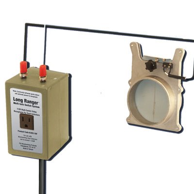

Hello everyone, I found this site through Google and thought you guys might be able to help me out.
For Christmas I am installing a VacPan in my fathers kitchen. A VacPan is an attachment that goes to a central vacuum system. I am trying to connect it up to a shop vac out in his garage. The VacPan has a low voltage foot switch that turns on the vacuum. Here is where the small problem comes in to play. (Stupid Low Voltage) but safety first right?
From my understanding I will need a 120VAC Transformer to 12VDC then a 12VDC Relay to control the 120VAC. I attached a diagram, I hope it uploaded. If this is correct my next problem is where do I find this stuff? Radio Shack now a days sucks, Home Depot has no clue, as does Loews. I just need to make sure I am buying the correct stuff and wiring it right.
Thanks everyone
Dave

A door bell transformer is only a transformer. You indicate DC voltage on your drawing. You need more than just a transformer to get DC.
Or you need an AC relay not a DC one.

Here is one ready made for you.
http://www.pennstateind.com/store/LRMSET110.html
Keep everything AC and you will be fine. The contacts on the relay need to be motor rated. A vacuum is a significant load. A tiny isn't going to cut it.
Here is one example of a motor contactor.
joed is online now   Reply With Quote
