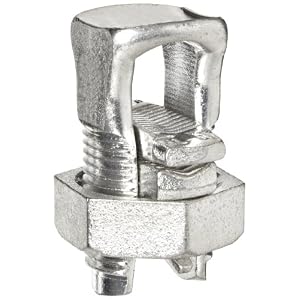

1. Size of subpanel in workshop? 100A?
2. Wire size from kitchen J-box to workshop subpanel using copper? #8?
3. Splicing aluminum to copper? Split bolts and tape? Ideal purples? Other?
4. Any other concerns with this plan?

I would run a new wire from the panel to the workshop. I would not splice AL to CU. There are too many conflicting reports. Purple wire nuts are rated for it, but I'm not sure they make them large enough for a #6 and #8. There might be some lugs that are rated for this purpose, but those could be on the pricey side.

Just buy dual rated split bolts... super cheap and efficient.

I've been researching splicing copper to aluminum. You are right, there are some conflicting reports about this type of splicing. Some concerns are with the bending and over stressing the aluminum wire while creating a splice.
I'm torn between running a new circuit and splicing onto the existing wire.
