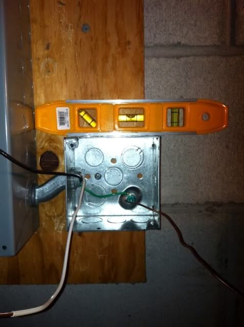

Updated
Finally got my electrical panel updated this past weekend.
I had a Federal Pacific Stab Lock 150amp.
This panel had a lot of issues with it. For one they lost the UL rating and the breakers have been known to both not trip or arch out at the panel causing fires.
Another shot.
I swapped in a new Square D QO 200amp panel I got at Lowes in a kit with five breakers. It was a good deal at $120. It can handle 30 breakers with ten of them being tandem for a total of 40 spaces.
Here is a shot of the feeder lines 2/0 wires I had to trim shorter to fit the new panel. You can see the anti ox paste that must be used when connecting AL wire to other metals.
Here are all the lines attached and torqued down. The two phases on the outside and the nutral and ground bonded in the middle.
This is just a shot of the panel plug I put on. I went with a four-plex box and will put two duplex receptacles in it. The box is a deep box so I don’t get too crowded in there. I will also be splicing my doorbell in here.
This is a shot of everything all done. I had some short wires and had to make it work. I will be rerunning some of the lines to clean it up a bit. But I had to have the power company pull my meter to do this and had to just get it done in the time I had. The inspector looked at this and gave me the seal and said it was all good to go.
Here it is with the door on. I have labeled all of the lines now that is not shown in the pic. You can see the Green inspection tag on the door.

Replacement of my old FP main with a new QO
Your inspector should have caught the two grounding wires in the lug that is only for one.
Jim,
your right that really sticks out. I am a non-electrician who has never done a panel change and as I looked enviously at the new service and panel I was thinking "what's up with the two wires in that one ground terminal"
Big B8,
If it were me I would relocate the wire going to the rods to a large terminal on the neutral but you might have to move whichever has sufficient length to reach the neutral bar. However, if you change anything that might trigger a new inspection requirement.
Kevin

Originally Posted by kevinp22 View Post
Jim,
Big B8,
Kevin
HHMMMM wounder why he didn't bring that up? I can move one the the ground bar then it should be good to go.
First time doing a full panel swap and there was a lot of learning going on.
We probably should have said check the instructions and or the sticker on the side of the panel to make 100% sure it is not rated for 2 ground wires (it probably isnt)
you mean moving it to the neutral bar, right?
Also, I cant tell from the picture but you bonded the neutral bar to the enclosure, correct?
