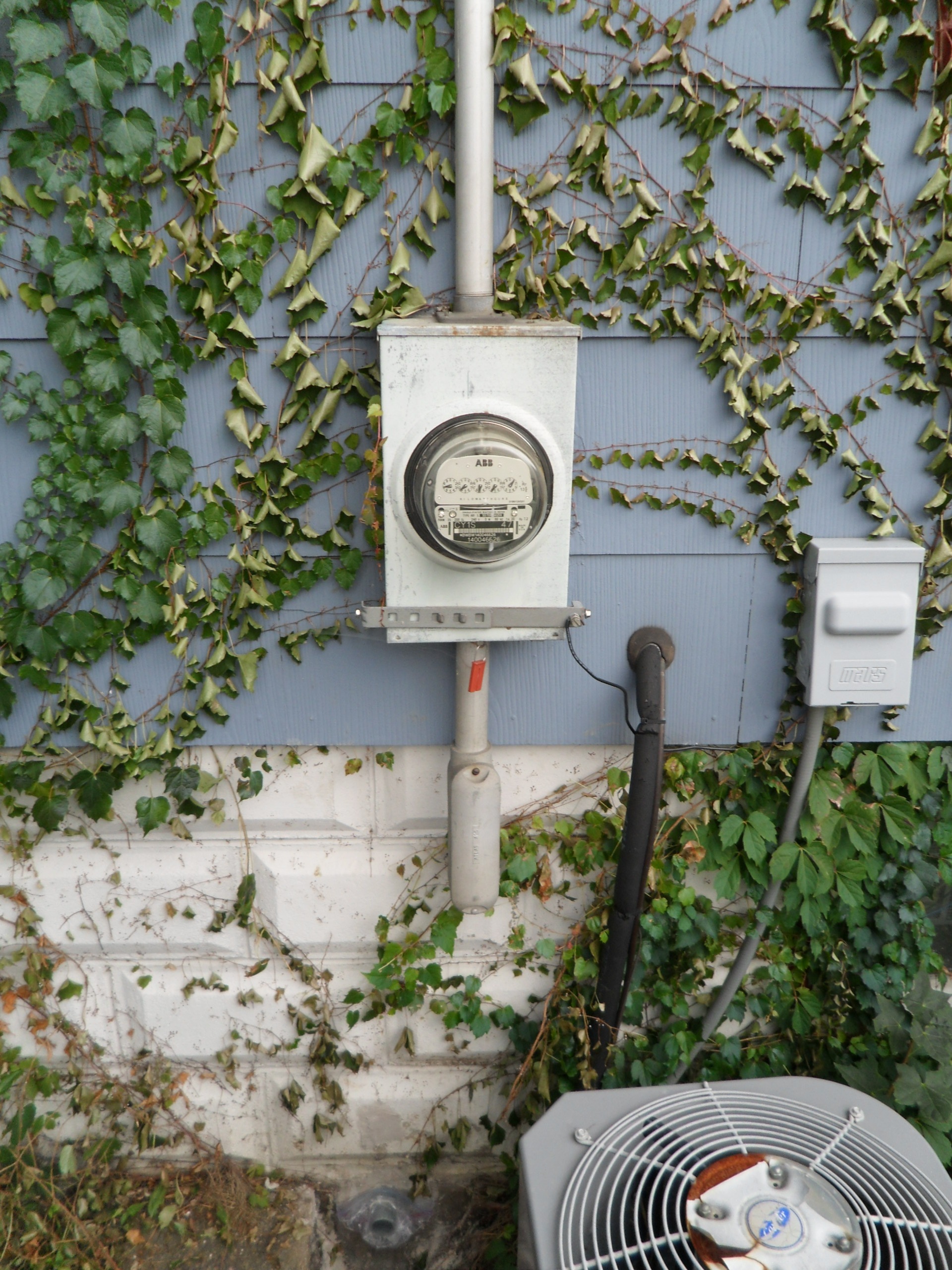

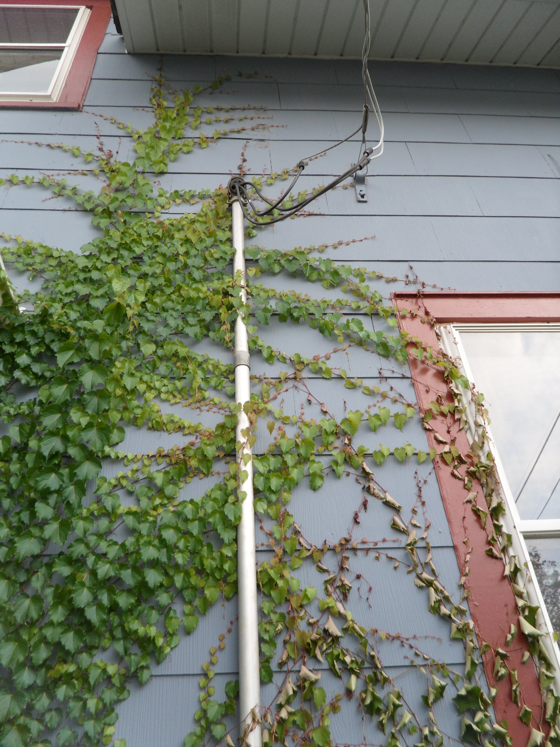

Service comes straight from an aerial feed, 2 hots and a bare.
Heads straight down the side of the house in conduit to the meter,
and straight through the wall into the panel after the meter.
Panel looks like a mess, I planned on tacking that once I had a usable garage again
f the house doesn't burn down first...
I wish I could get a better shot of the neutral bar, but I'm not keen on touching any
wires that I don't have to, especially that cloth one.
The lone "ground" wire attached to the meter is attached to the cable TV inlet box.
I apologize for the size and quality of the images, snapping and posting everything
from a phone. Again, thanks for any input.

A few better shots
