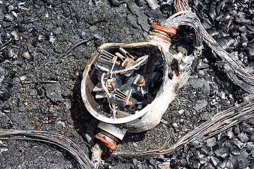

http://www.pieperpower.com/images/arc_flash.jpg
this link will show how powerfull the flash if something short out
http://www.spril.com/rapidan/Images/...PowerMeter.jpg
this link will show what the electric meter look like after fire damage
now you can understand how serious this is if you dont follow the code and safety here
