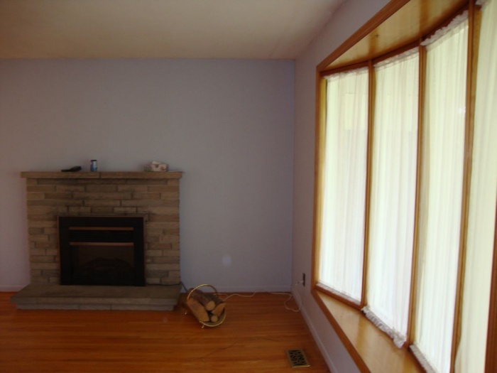

Electric fireplace
Typicaly, what is the best way to wire one of these "permanently"? Mine has a plug that looks like a lamp cord or a radio cord (standard low guage wire for a small item) and I'm thinking of drilling a hole to the crawlspace then cutting the end off and wiring it through a junction box then run some 14/2 from another circuit to that box. I'd probably add a cut off switch too, in fact I can just use a rectangle box as the jbox and put the switch in there.
Would this be ok? Or should I rid of the cheap wire and remove the fireplace then wire it directly? I'm not sure how the fireplace comes out, I'm afraid it may be bolted down in cement and all, so it would be a big task to remove it. if the fireplace comes with this cord then I'm guessing it is safe and tested. Though if there's a fault wonder if that wire would burn before the breaker trips.

Posts: 2,956
Electric fireplace
It has a small heater on top. It gives out a fair amount of heat, but probably less then a big heater you'd buy with a heavy duty 3 prong cord.
also the run with the cord wont be long. Basically I"ll have a square box beside the fireplace, but in the basement, the cord will run from the fireplace into a hole in the floor then to the jbox. I'll probably tape the cord where it goes through the hole just for extra protection, then I'll caulk it (so bugs don't go up through the hole).
It looks like the fireplace is built in, but there used to be a real fireplace there, so really not sure how it was installed. Maybe it does just pull out. If it pulls out then it will be easy to run romex wire directly to it.

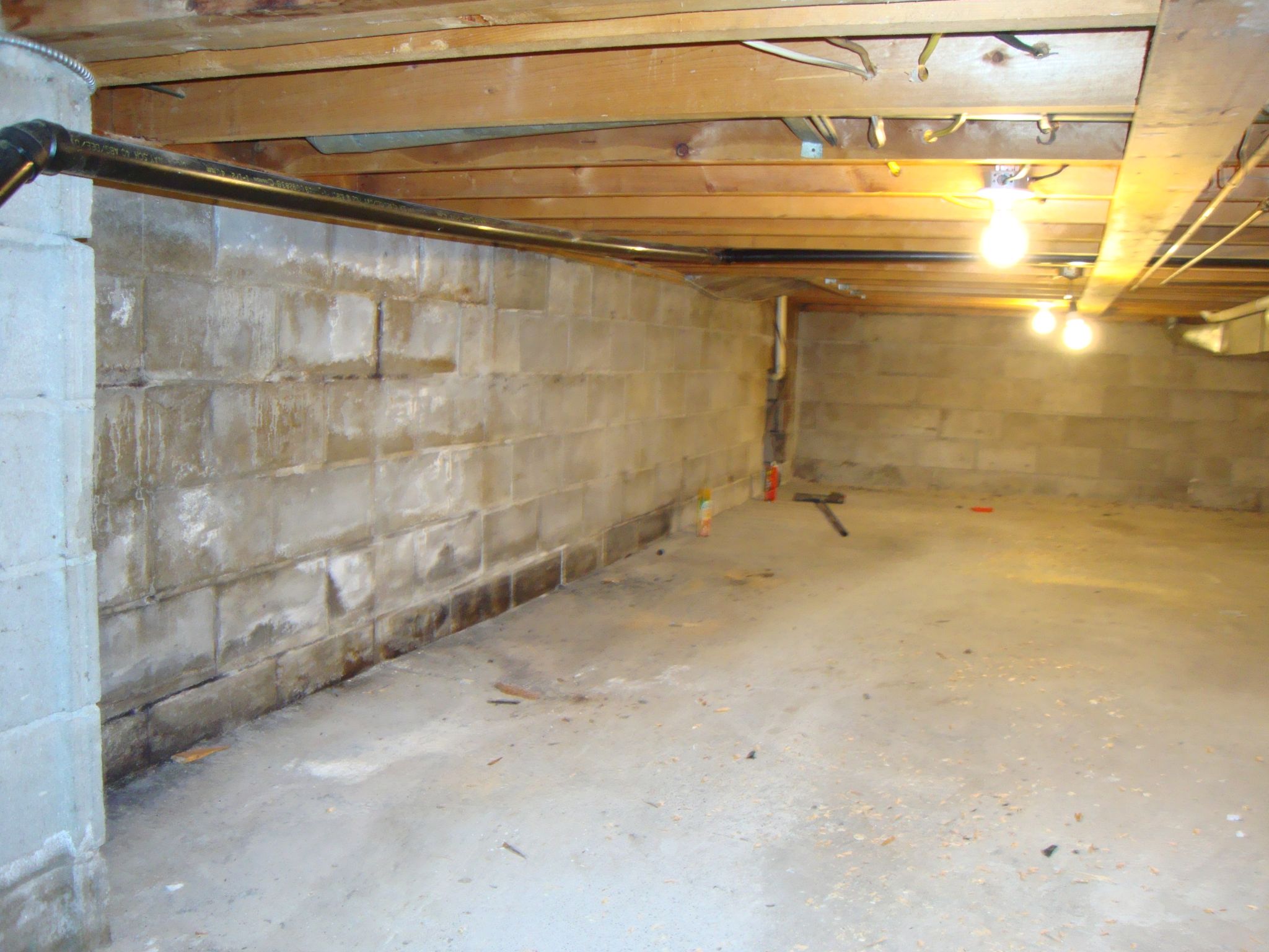

Posts: 2,956
Electric fireplace
It's all cement so I want to avoid having to drill through there.
This is the fireplace:
This is under the fireplace:
http://gal.redsquirrel.me/images/hou...9/dsc01695.JPG
Where the white pipe is going to the hole, you'll notice an incline of cement, that is the fireplace. What I want to do is drill into the floor right beside that and run the wire there. This used to be a real fireplace so it's cement everywhere.

Do you know the wattage of the heater?
Most of these have 16 gauge wiring, so 14g would be heavier & better
Myself I'd only replace the cord if I could drill inside the fireplace & eliminate it from site entirely
If you drill to the right of the stone you could put an outlet in the basement & either disconnect & reconnect the cords or install a new cord
If that is an extension cord in use to connect it then you are far better off adding an outlet in the basement
Most of these are around 1500w & you aren't really supposed to use an extension cord (but many people do)
The extension cord can overheat, the normal cord can usually get hot
If you do disconnect the cord & the heater is a 1500w model I'd get a 14g cord to replace it
