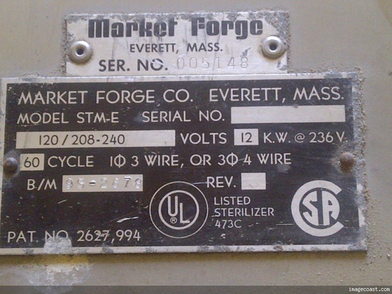

CAN i hook this up to 120 ,,,,,,,,or does it need 220 V ???????// any electricians help welcome.....
ps ...this is a commercial Autoclave ( sterilization ) unit we bought used 6 years ago ...........I want to hook it up finally !

First of all.,,
You will need to find the manufacter nameplate and look for voltage and amp requirment that will useally tell you what voltage this equiment is set up for and how much current it take.
That is the key item once you know the number just post it here we can go from there.

ELECTRICAL REQUIREMENTS: Unit will be rated at 12kW at 236V and will be equipped for operation at: □ 208-240V, 3 Wire, 1 Phase, 60 Hz □ 208-240V, 4 Wire, 3 Phase, 60 Hz □ 220V, 1 Phase, 50 Hz □ 220V, 3 Phase, 50 Hz

Ok that equiment it can be wired for single or three phase supply however I am pretty sure you have single phase supply source so you will denfity need 240 volts minum of 50 amp circuit capaity do this unit have any motour in there ?

Now let bring up to the date you will have to ingore my last comment with one part due you have updated info you will have to bring in 4 conductors (wire ) I will check little more info in little bit to see if I can find the wiring diagram of that unit to confirm this part.
Second thing is this unit is on your resdetnail area if so I am pretty sure you will have 240 volts without a question.

Yes Marc , I have 240 volts capability to this appliance if required , just a bit more work & wire to do it ......... what is the ( 120 / ) ON THE MODEL # ID TAG for if it absolutely needs 240 V ?

120/208 is for three phase wiring
