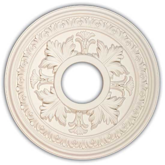

What I think I need is some kind of plate to place over the hole, wide enough to cover the damage. I would screw the plate into the box and then attach the bracket to the box THROUGH the plate. I found a number of plates at Home Depot that would be perfect except they have no hole in the middle for the wires to go through.
So here are my questions, if I haven't lost you already:
1. Am I right that I need to find some way to make up for the damage to the ceiling? Does the metal plate idea sound like I'm on the right track?
2. If so, do you know where I could get the kind of plate I need?
3. Or am I worrying myself over nothing, and there's really no need to give the bracket something to tighten up against? Could I just get a longer screw to make up for the embedded corner of the box and then maybe put a washer on the other side and be done with it? Will that make the whole operation less stable?

you could also try using this
buletbob is offline   Reply With Quote
