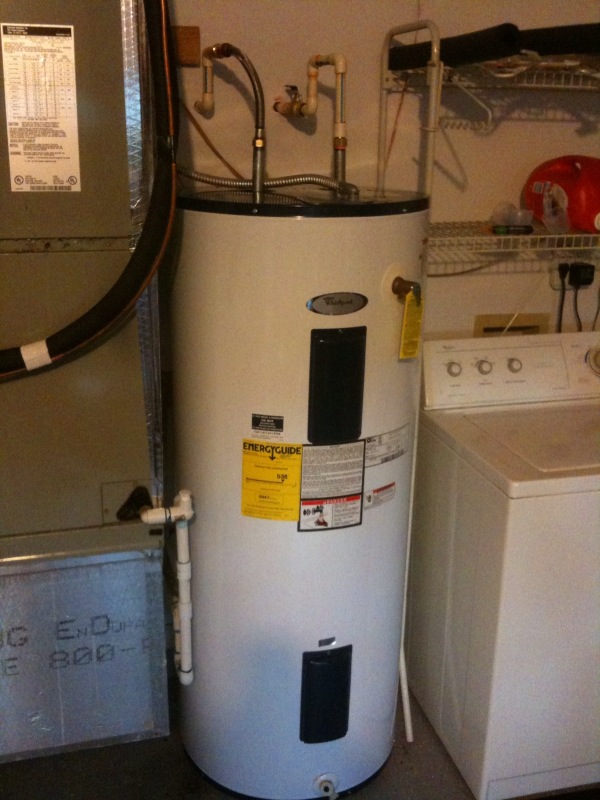

Here's what I ended up doing. Fun DIY project...
I wanted to use the braided flex for both connections but it just didn't work out on the cold side. The bend would have been too hard.
I had to replace the shut-off valve along with the water heater. Pretty bad when the valve failed as well as the tank... it made the interim time a bit of a pain since I couldn't shut off water from there.
Electrical was MUCH easier than a tankless I'm certian...

Looks Good Takes up alot more room Save Some $ and buy a hot water timer have it turn on when you use the most hot water. I would not own a Tankless Water Heater. Good Job
