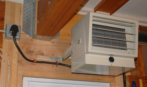

I will be installing a Dayton Electric Utility Heater #3UG73D in my garage.
It requires 240v. The power block on it has connections for White/Black/Green.
I have plenty of panel space. I have a 240v 30A breaker and 10-3 cable.
I've wired a 120/240v dryer outlet before (black(hot)/red(hot)/white(neutral)/green(ground)), but not 240v1p...
Help?

Remark the white wire on both ends with a red or black magic marker. Connect the white and black wires onto the 2 pole breaker, and connect the ground wire to the ground bus.
Are you sure the termnial block shows for a white/black/green connection?

I read both posts over twice. Is there a question?
I'm not sure what you are asking.
240v is simply two hots and a ground. Ground can be green or bare.
If you want to use the 10/3, use the black, red and ground. If you use 10/2 you can use the black and white and ground. The white must be re-marked black or red with a marker as JB said.
Sometimes I feel like if I answer any more questions it is like someone trying to climb over a fence to jump off a bridge and me giving them a boost.
