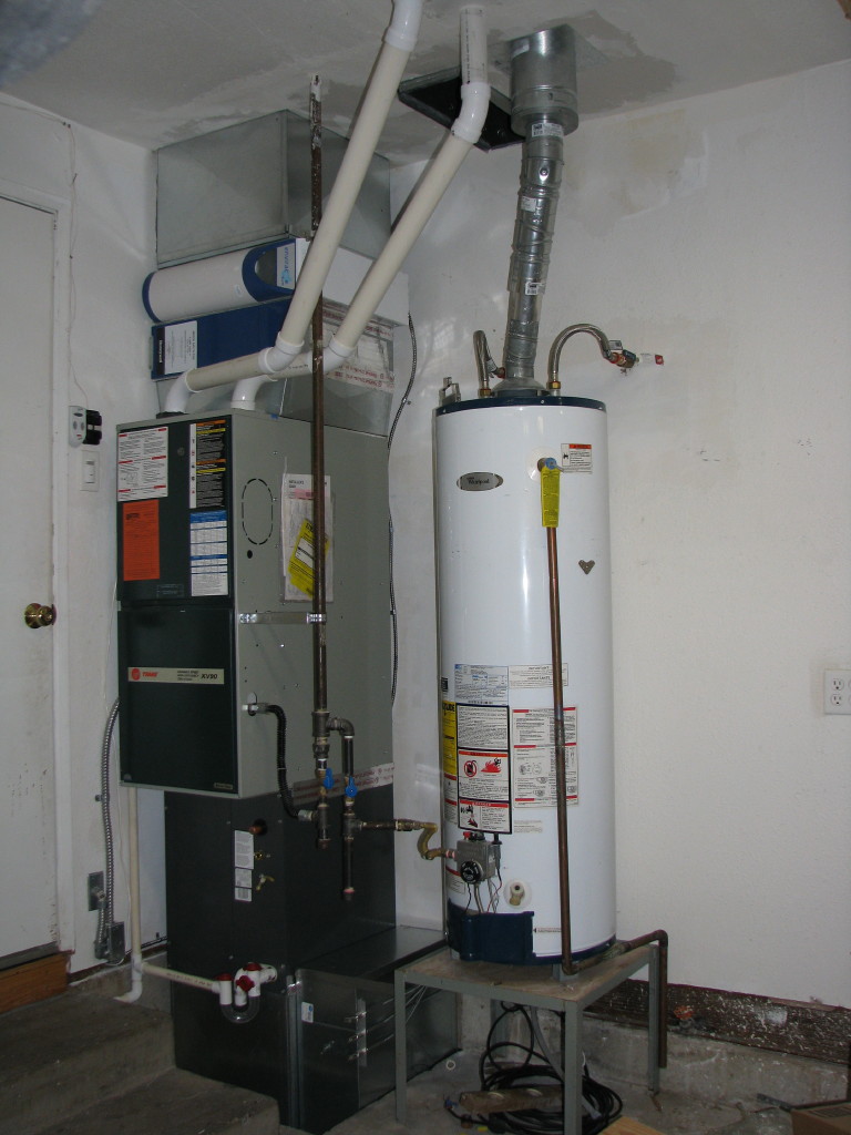

I ordered my heat pump, coil, pad and txv valve online from http://www.acwholesalers.com/
I got a Goodman 14SEER heat pump and a 3636 coil. My existing furnace was a Trane 80,000 BTU furnace 92% efficient that was put in in 2002. I was really annoyed at the quality of the install back then which helped nudge me into to DIY. I am still using this furnace in my new setup.
Here is what my stack currently looks like, I need to connect the re-fridge lines and run one more thing of ductwork from the base can to the celing:
I ordered my line set and thermostat from www.pexsupply.com
Then for supplies and ductwork I used locally here in Portland OR:
John Stone Supply (Near Burnside and Sandy)
Johnson Air Products (near OMSI)
Vinje and Sons do it yourself heating (http://www.doityourselfheating.net) over on SE 78th & Stark.
I'm actually not done yet as I have not had the system brazed and the condenser unit is not setup outside yet.. I spent the last 6 months re-doing ductwork. Would have gone really fast but I have a new son and have no time for projects..
Do you know what the SEER of your old unit is? do you have the model number?
Are you looking at something like a Goodman 93% downflow 70,000 BTU GCV90704CX? They have that that unit for $1250..
Or you could get GCH90703BX (Not variable speed) for $869..
