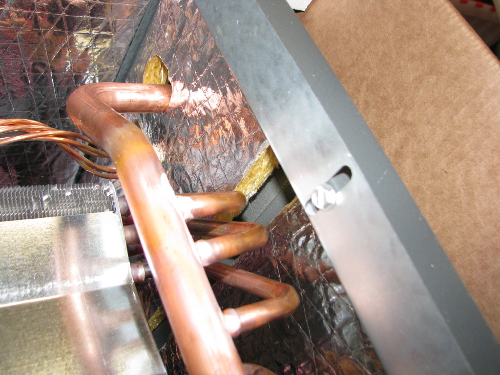

Type B:
This is a fiberglass insulation with a reinforced foil liner that come in contact with the air. It lined my cased coil. It appears to only be glued on the inside and held in in place on the corners via mechanical wedging-in-place. This would be my second choice.

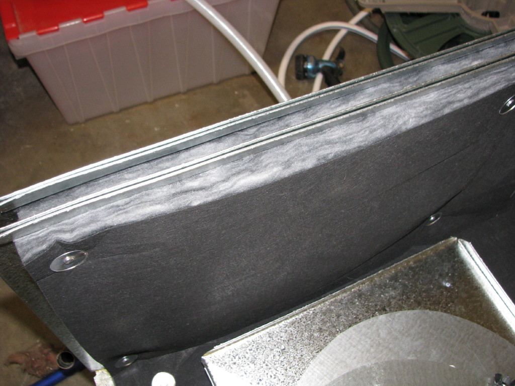

This is the typical furnace liner material that I can by in rolls of 100 feet for 300 dollars, and it is what my fabricator used on my custom sheet metal. It isn't very dense and if it is only glued in place I would worry that it would separate the liner from the fiberglass body. The welded pins are helpful for this reason. Since I can only find it by the 100 foot roll and I can't get away with just gluing it in place, this is my last choice.

Call your fabricator and ask if you could bring your pre-fab in and have him cut and glue your example C. That is the most common duct liner that most use. That way you would not need to buy a whole roll. Or, as I said above, go to your fabricator and buy the amount of that insulation that you need and DIY, though he can probably do in about 15 minutes with his cutting table and spray gun and banger pins.
This should be the easiest part of your project so far.
