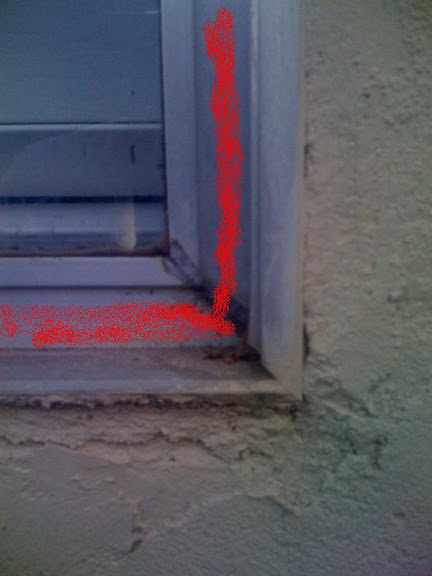

hello everyone
Got a quick question in regards to the void left in between the new vinyl frame and the old alum frame. Not within the alum tracks, but the space left between the old frame and the flush fin/stucco fin. I attempted to depict the area in question with the follow image (red area). Do you insulate that void or leave it "empty" to allow water/moisture to escape??
Also, I wanted to "build" a better "foundation" for the new windows to sit. I was thinking about using low exp foam to fill the alum tracks and square off any excess foam (any foam above the highest tracks, all four sides) and then setting, shimming the retro window in place. So the window would be supported by the highest parts of the track and foam. My thought was to allow the foam to cure without the window in place to avoid any over expansion and bowing of the new windows (since I'm not a pro at foaming). This wouldn't give the window the best "seal" but could help avoid breaking my new windows from the start. Any opinion on this??
Really leaning toward the Simonton Impressions 7300 BUT I cant find someone who will sell them to me...the search continues...Thanks!
http://lh3.ggpht.com/_gVM2KamiDos/Sv...76/window2.JPG
Ron6519 11-03-2009 03:17 PM
The replacement window should have been measured so that the window would be seated on the two sides and top. The actual window should project past these stops. There should be no space on front of the vinyl window and the aluminum frame. If you have space on the sides of the window, this is normal. There should be 1/4-3/8" on the sides for adjustment. This area should be shimmed and then insulated. If you like foam, use the low expanding product made for doors and windows.

pcl586 11-03-2009 05:28 PM
Thanks Ron for the feedback...the new vinyl window would be resting on top of the alum tracks (back away from the outer frame) and thus leave a void between the outer track wall and the outer vinyl fin. wouldn't it??
Ron6519 11-03-2009 08:12 PM
This is not the way to install these windows. There is no way to keep the water out by, "filling in the space".
The window needs to be installed in a way that seals the window from water intrusion. Using a replacement window that sits in the aluminum frame might work, it depends on how you could seal it and cap the top.
You can't just get a window close in size and make it work.

pcl586 05-19-2010 07:39 PM
1 Attachment(s)
perhaps this photo could clear up what I'm trying to ask...the white lines are the "stucco" flange (flush fin/retro rip).
As you can see my old alum frame sill and jamb are recessed back (toward interior of the house) but my measuring point (inner white line) would be back and in. So the new retrofit window would sit on the inner white line and the flush fin would butt up against the stucco. (not saying its correct but thats how I'm visualizing it??). With the new window in place there would be a gap around the bottom sill/jamb.
Am I just complete off on this...?? Thanks again
Tom Struble 05-19-2010 11:44 PM
so your plan is to install the new construction vinyl window over the aluminum frame from the outside?
when you read about leaving the existing aluminum frames on stucco houses to keep all the wrb and flashing intact,you would be using a insert window and installing it from the inside

Ron6519 05-20-2010 12:14 PM
The lack of a formal flashing detail on the perimeter, integrating it behind the exterior fascade would concern me. Any other retro fit scenario would not just rely on caulk to shed water coming down the wall.
Ron
Tom Struble 05-20-2010 03:08 PM
hm mm so you want to foam in between the vinyl flange and the face of the aluminum window?yea i think that might be a good idea to reduce the chance of condensation but you have to make sure you leave some drainage areas on the bottom of the windows
i have never done this type of install,looks interesting and with proper sealing details...i don't know:laughing:

pcl586 05-20-2010 07:24 PM
why can't you get the windows?Bradco carries simonton
i was thinking to try and fill in as much space as possible but not over doing it, especially with the foam. yeah, leaving perhaps the bottom sill empty for draining purposes makes sense and a good idea.
boy, i wish my old alum frames were the same kinds that are on ALL the retrofit DIY videos. The frames that are completely flush to the exterior already and also where the fixed glass comes right out after removing the middle brace!!
