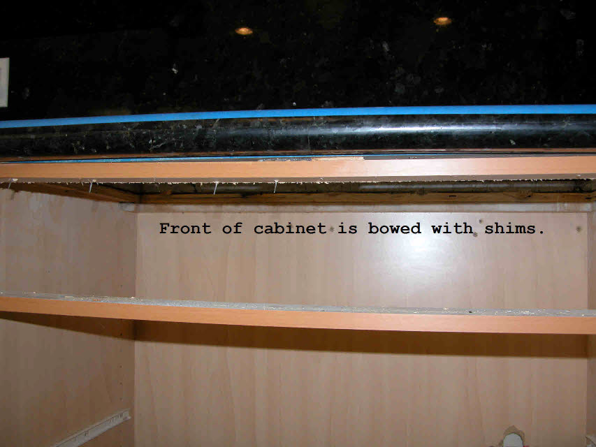

*** The gap is not between the granite and the wood. The granite
touches the wood - more or less. Since there is such little wood,
it bowed down when they were installing it, and there are shims
between the bowed down wood and the granite. And a blob of epoxy at each shim.
The quarter inch I speak of, is between the wood support and the doubled LIP of the granite. In other words, the granite sticks out into thin air a quarter of an inch before the doubling starts. I'll try to take some pictures. They'll come in handy also if I go to granite shops with

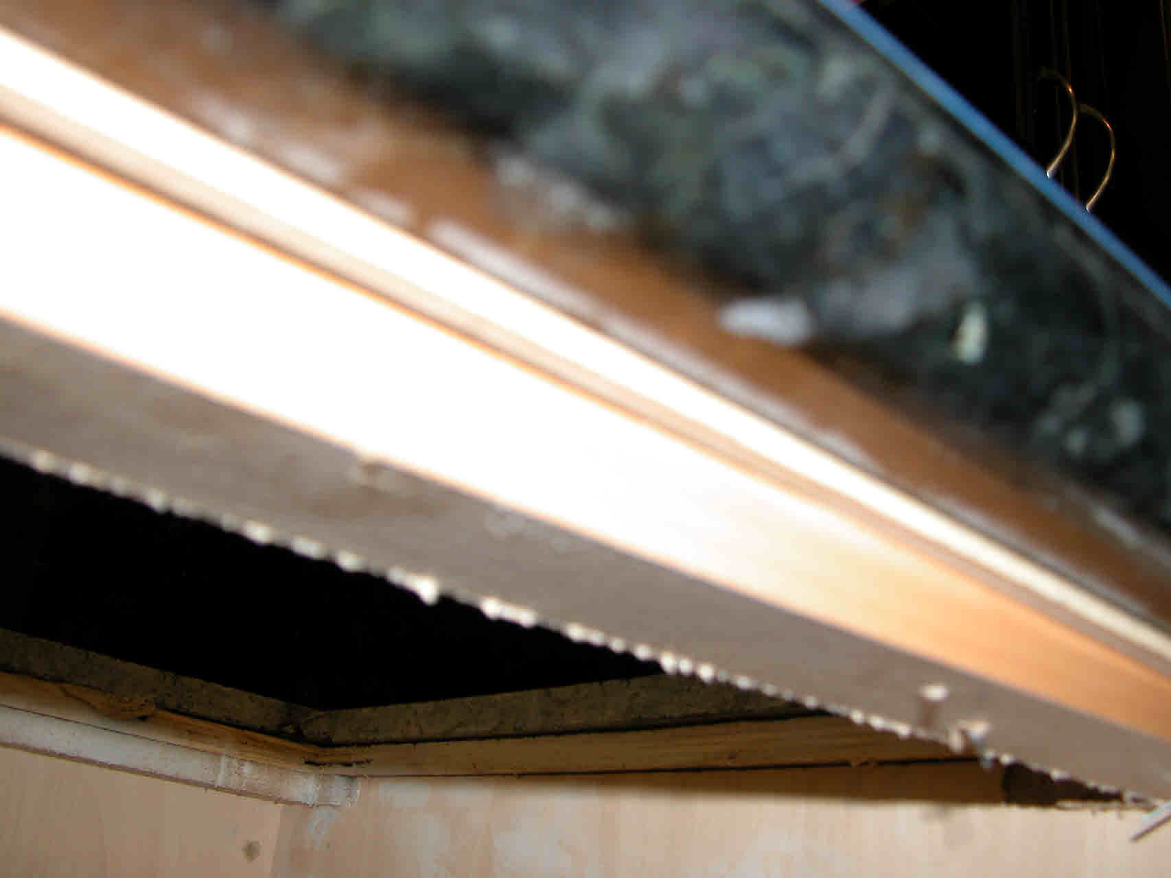

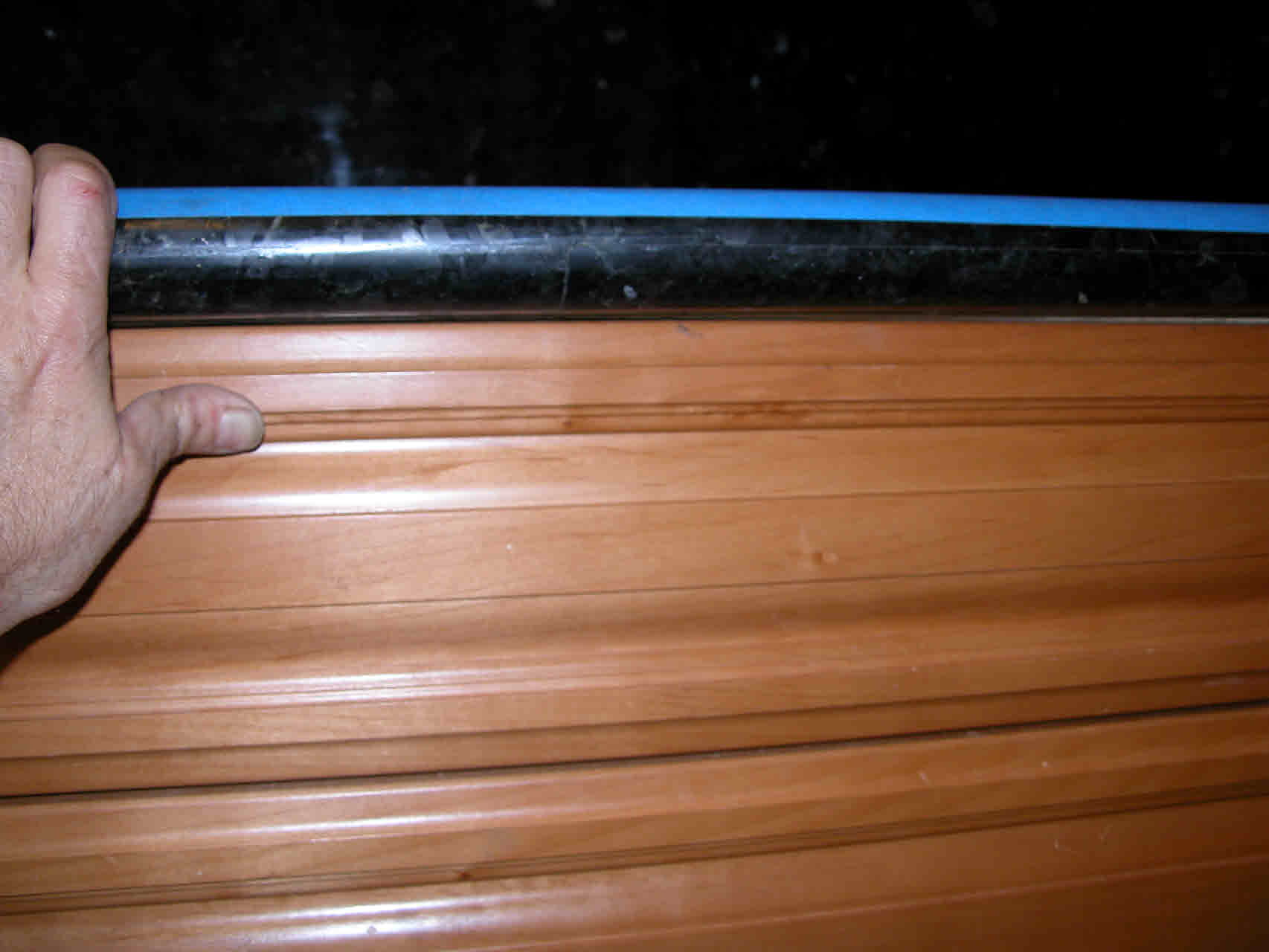

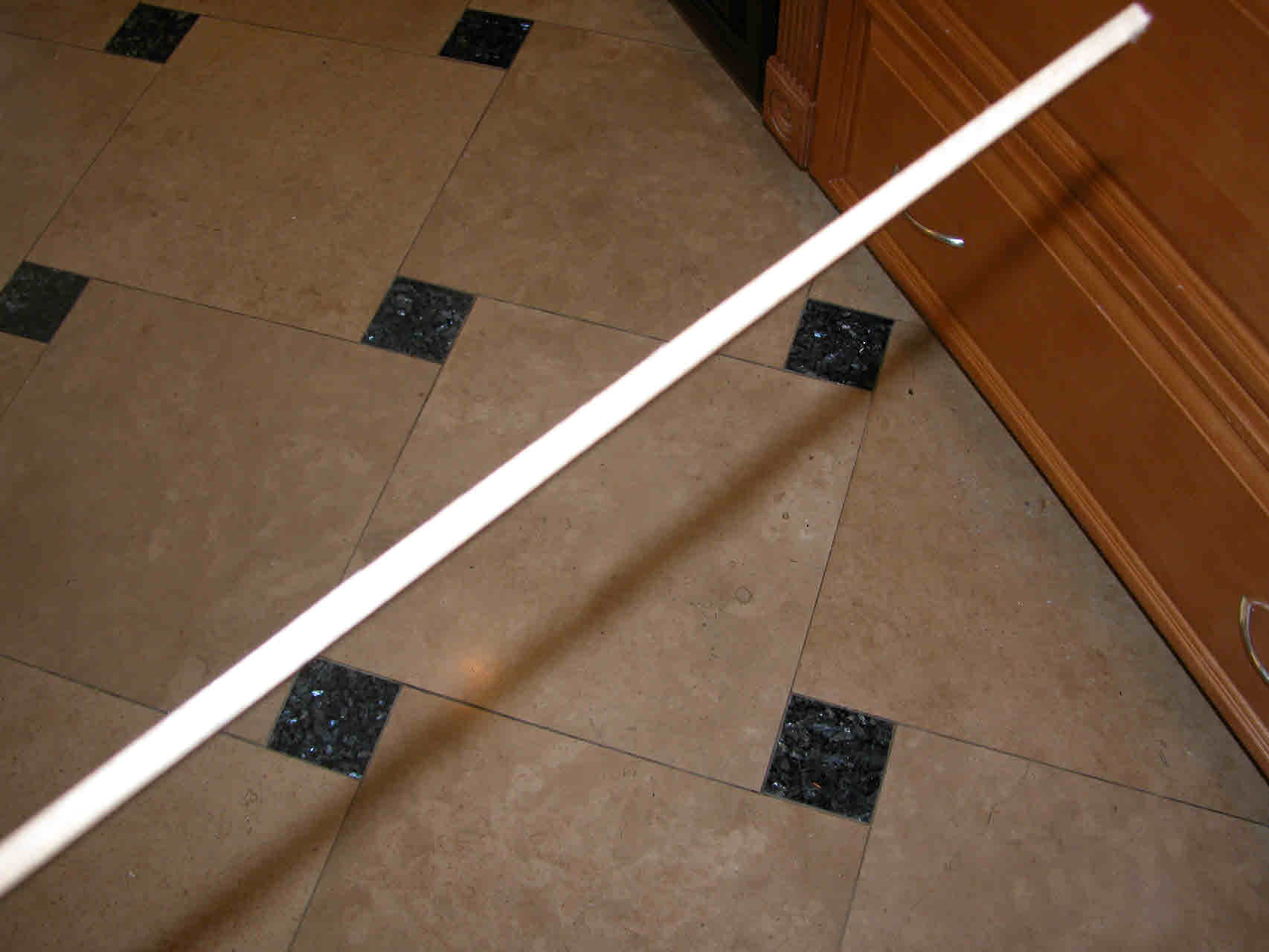

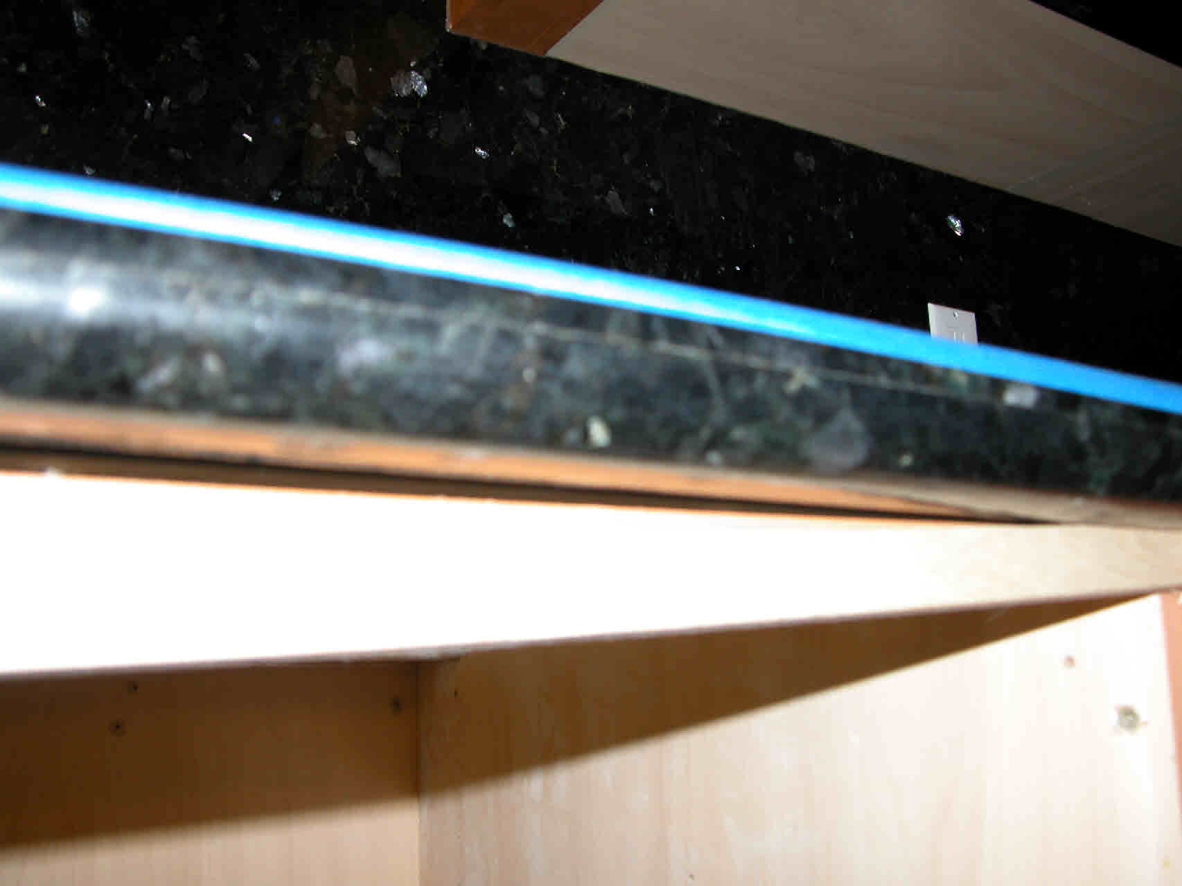

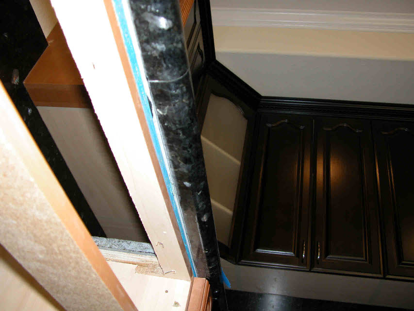

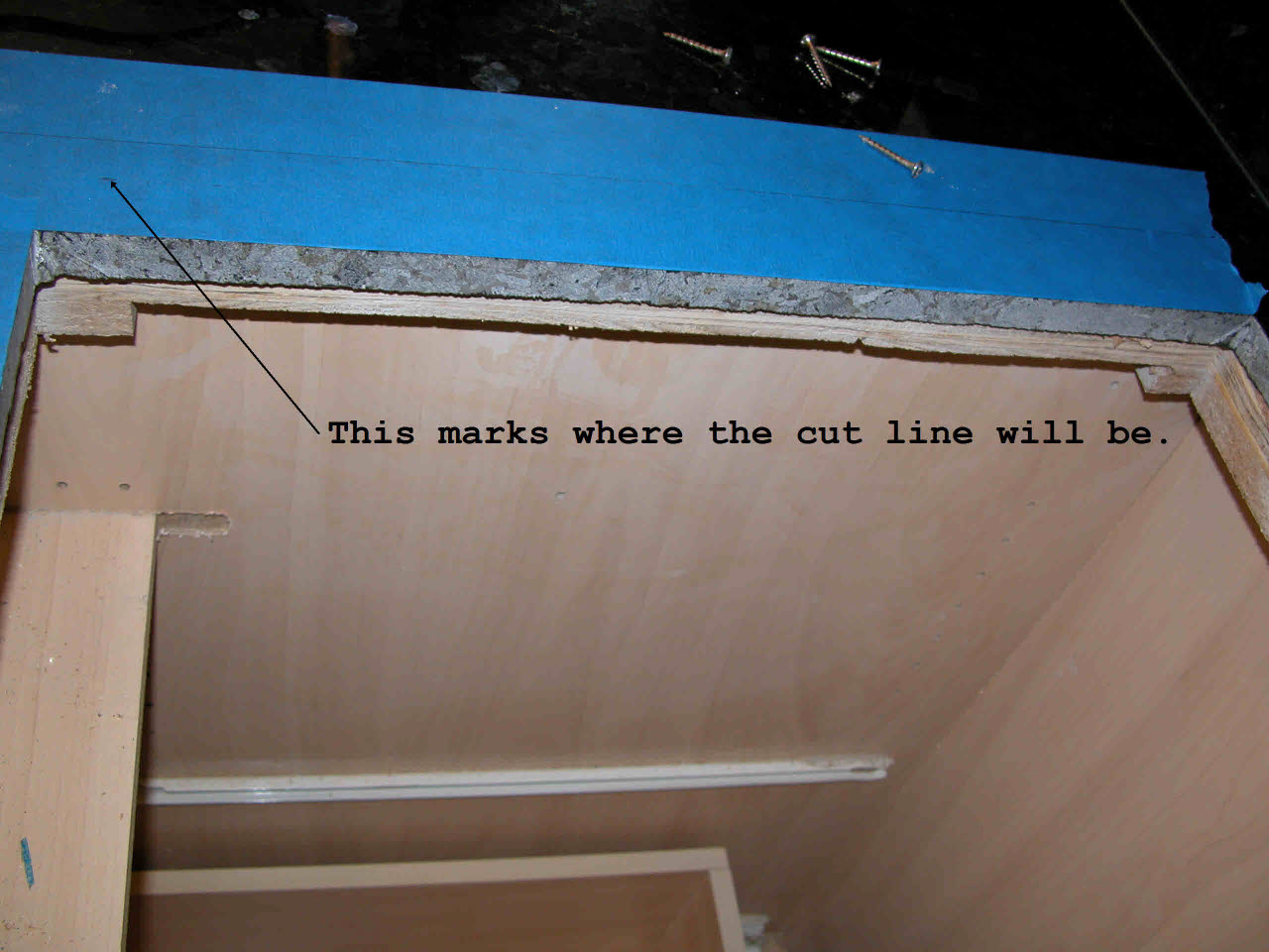

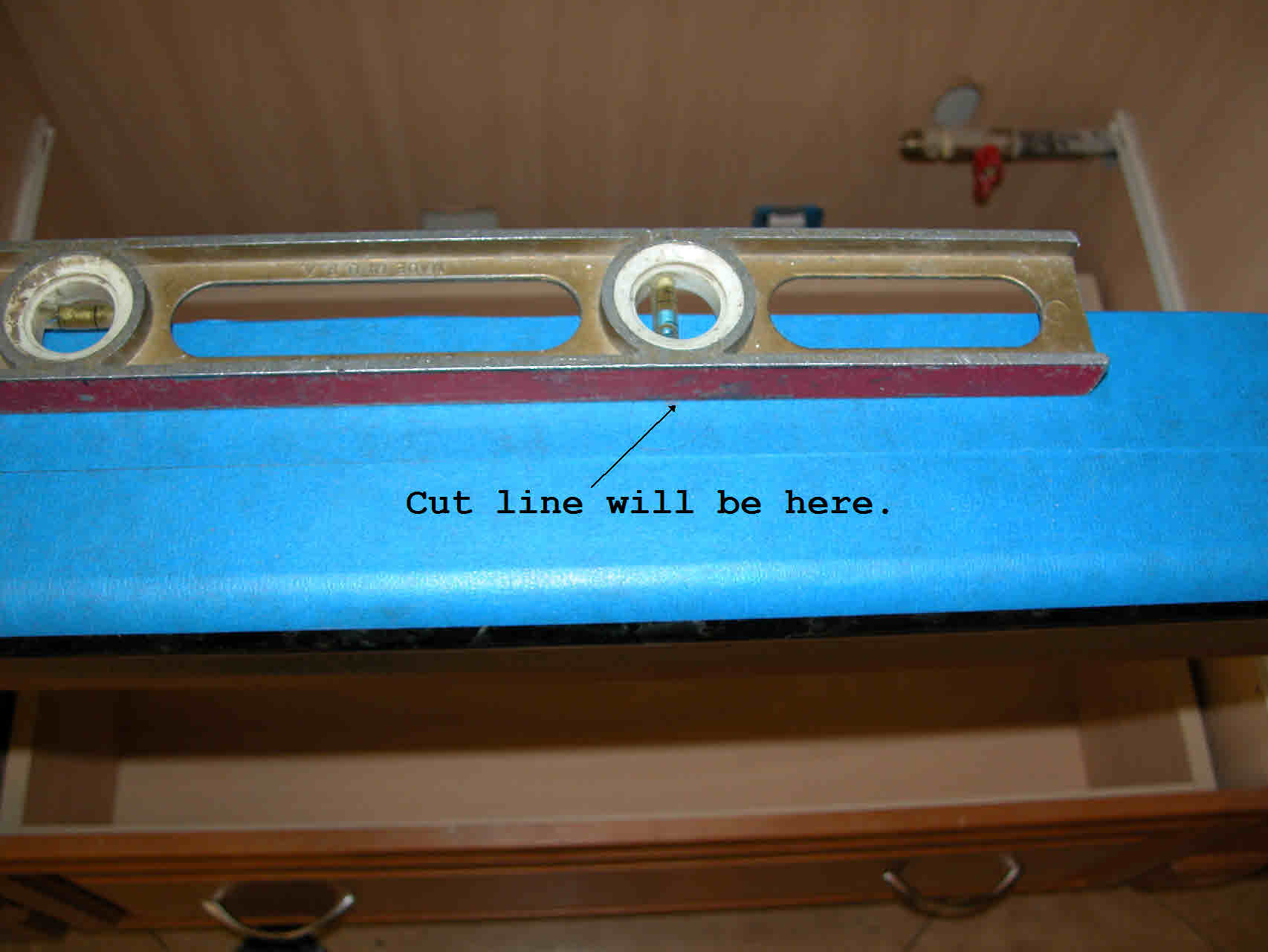

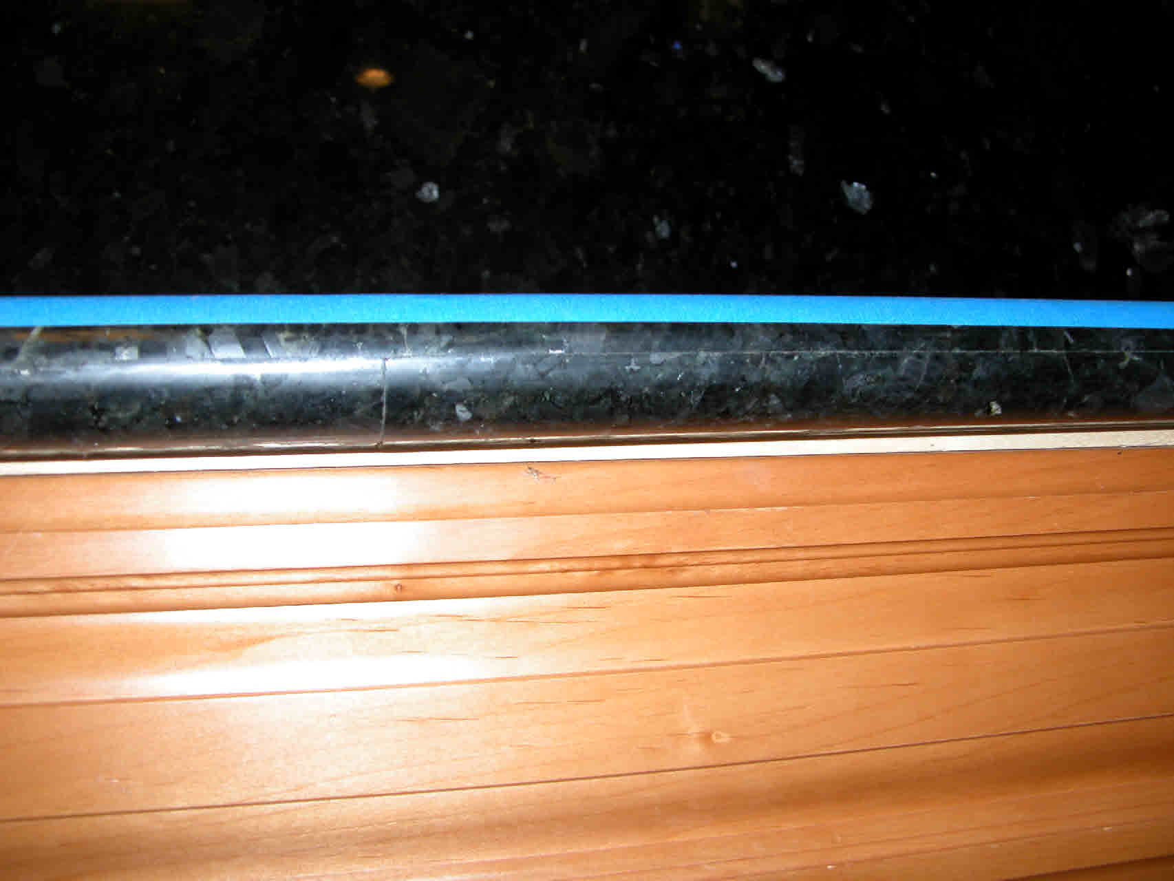

OK, here are some pictures.
First, the front of the cabinet, showing the minimal support for the granite lip:
Then from the top, showing where the L/H cut line will be.
Then a view under the front lip, showing how much ( or little! ) wood there is:
Then a view of the top front. The forward edge of the level is right on the cut line.
Here's the strip of aircraft grade plywood to fit in the slot in front:
Strip of plywood sliding into the lip:
Strip of plywood farther into the lip:
Strip of plywood loosely captured by false front. It is resting on top of the false front, which becomes a structural member. The false front will transfer load from the middle of the granite lip to the bottom edges of that particular cabinet bay. By "edges", I mean the L/H and R/H edges. That's where the cabinet is stiff. There will be a piece of 1/2" or 3/4" plywood completely filling the drawer hole that the false front covers.
False front rammed home up against the plywood strip. Note that the gap between the false front and the actual drawer under it is proper. The plywood strip disappears almost completely.
I will also epoxy the plywood strip into the slot. Yeah, it's belt and suspenders.
Dimensions:
The existing front lip is 3 7/8" wide. I will have to cut it down to 2 5/8".
The bullnose is 1 9/16" thick, so the granite itself is half of that, or approx 20mm.
The existing wood under that lip is 2.05" wide. After the cut, there will be 0.925" left. With my quarter inch of plywood, that gets us 1.175 inches of support. Call it 1 1/8".
- JerryK

Old 09-14-2011, 09:23 AM   #12
Join Date: Jul 2011
Posts: 148
Modify Granite Countertop
Originally Posted by md2lgyk View Post
Why can't you the 1-1/4 inch from the back of the hole? Or half of that from both?
*** You know, I actually could. I thought I couldn't because the
manual for the stove specifies 2.5 inches of clearance from the backsplash.
But I talked to tech support for the stove yesterday, and he told me that the 2.5 inches is actually from *combustibles* at the back. From a non-combustible granite backsplash, less distance is needed. More like
1 1/4" IIRC. So I do have 0.875 inches that I could cut off at the back.
Supposing I cut 1/2 inch at the back, that leaves me only 3/4" to cut off at the front. MUCH better. Thanks!
- JerryK
