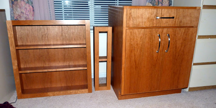

I love mine. I'm not much of a woodworker. In fact, that's an understatement. But with a Kreg I was able to make decent joinery without many tools. The maple bed I made for my son was in their newsletter a few months ago, and my first project was cherry cabinetry for my master bathroom.
Not bad for a guy with a drill and a circular saw.
