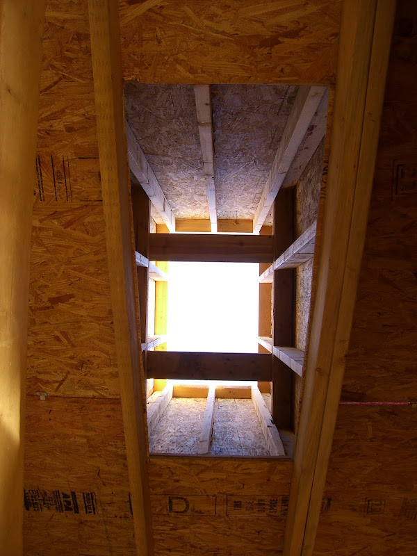

We have a metal flue, wood burning prefab fireplace.
Ever since we moved in (2 1/2 years ago, new construction), when it is windy, we can hear a rattling inside the chimney...it can get pretty loud at times, like something is knocking against the metal flue. I didn't think a whole lot of it at first. I thought maybe the covering up top was rattling or something needed to be screwed down.
We called a chimney sweep out to let us know if the flue needed swept, and we asked him about the rattling. When he was up there, he said he could push on the chimney and move it 2-3 inches back and forth and he said it was hitting the metal flue and making the noise when it is windy. When he was moving the chimney around, my wife (I was at work) said it sounded just like it does when it is windy. The guy said he had never seen that before in 20+ years of being a chimney sweep.

And I was smart enough to take a photo of the inside of the chimney, looking up, during construction of our house.
It looks like it is just mounted to the roof decking and the framing of the chimney doesn't extend inside the attic. Should it extend down and be secured to the base of the trusses? Or would that risk popping drywall nails?
What is the proper way to secure this type of chimney to the roof/trusses?
And what would you guys do to fix the rattling and swaying of the chimney?

Is this even a real chimney or is it decorative? It looks like faux brick or brick facing? I don't see real masonry. I am wondering of strapping the flu would cap it from slapping around the inside of that faux chimney frame?

It's a real chimney...but it's framed and has siding on it...there is no masonry...framed, then plyood/osb, then siding. Like I said, it's a wood burning prefab fireplace with a metal flu.
He is saying the entire framed chimney structure can be rocked 2-3 inches when pushed, like it wasn't secured properly to the roof. He is saying it's not the flu that is not secured, it's the entire framed structure that rocks. I posted the picture above to kind of show how it is secured, and was curious if this is correct. I'm also curious as to what is the best way to stop it from rocking.

Assuming your metal flue goes up the center and as you say it is stable, that is an awful lot of wobble from that chimney to make the noise.
Weird. It looks almost like someone just slid the chimney framing down down between two rafters and let it sit on the OSB on two sides and OSB with 2by under it on the others and that there is nothing really holding it in place but maybe a nail or two on the sides of the base where there is 2by? Hopefully there is a nail or two where the structure meets the rafters but that is not enough. I cannot think of an easy way to fix it without tearing something out to get to at least the base.

Looks like it's time for reconstruction---House is out of warrantee?
Pealing off the siding might be the easiest---then the OSB--then fix/brace and properly attach the framing--

All the chimneys like this that I have seen here have been framed right down to the base of the trusses, or right to the floor in some cases. Here's the cross section from a client's house plans to show how its done; this one is intended to have a EIFS type finish but the construction is much the same no matter what the outside is finished with.

The chimney sweep came back out, reinforced it some more, and that seemed to do the trick. We've had more than a few nasty storms come through, some pretty windy, and not a peep from the chimney. Not a single rattle. Seems solid now.
