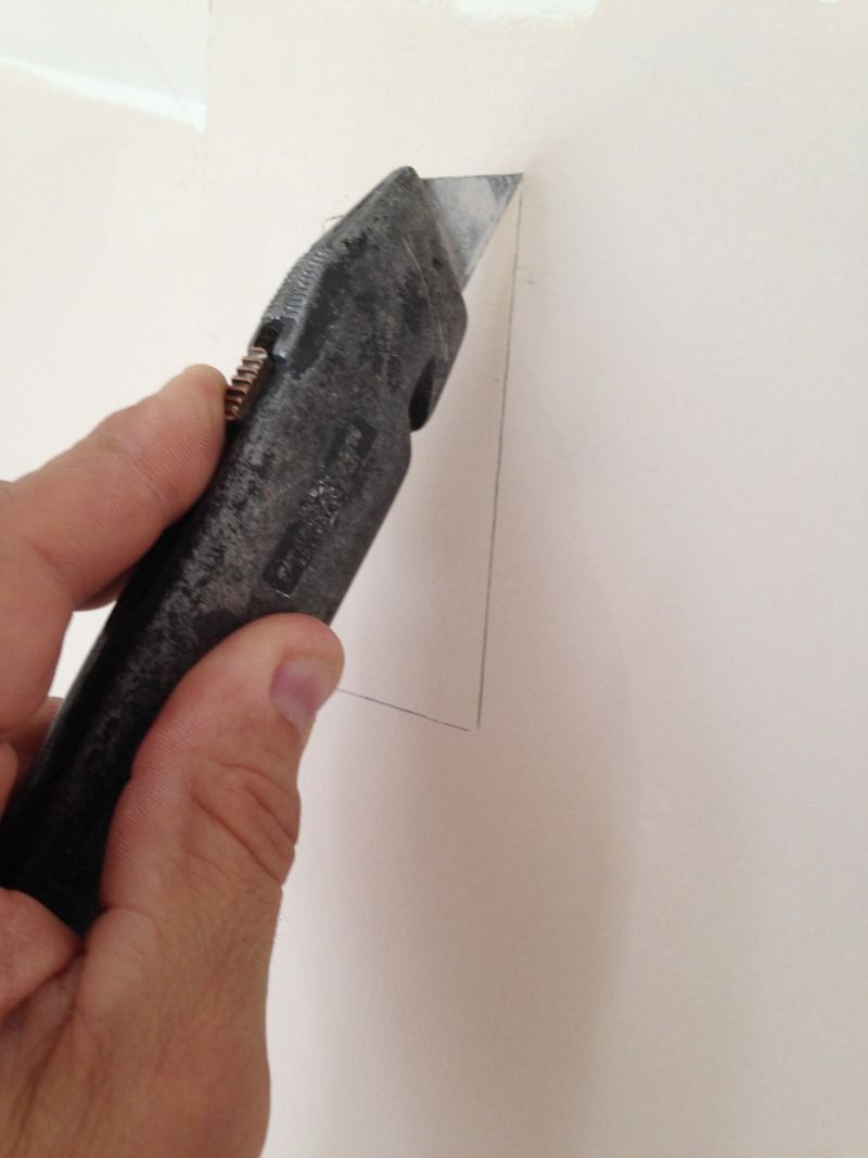

I've found it's easier and less messy to cut the holes with a box cutter. Takes a little longer but the hole looks a lot better and very little mess.

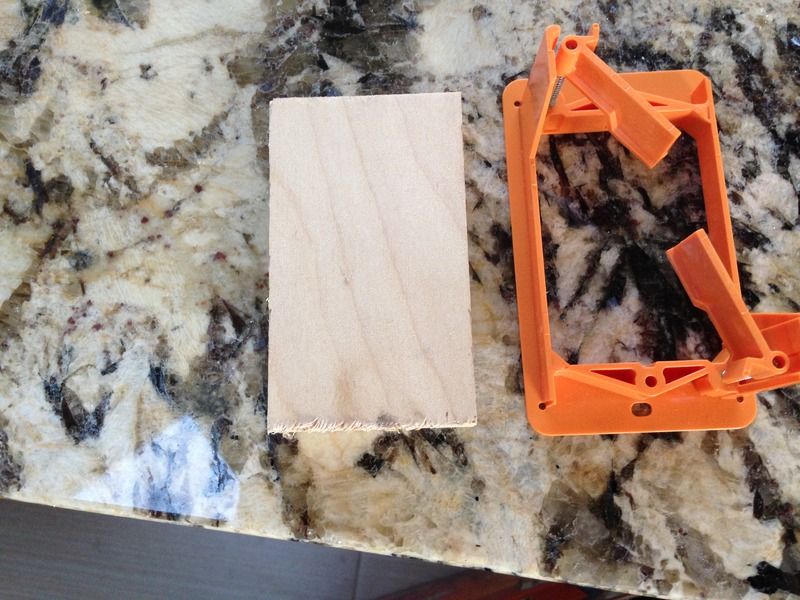

First I made a template from scrap wood. Saves a lot of time.
Then cut the hole

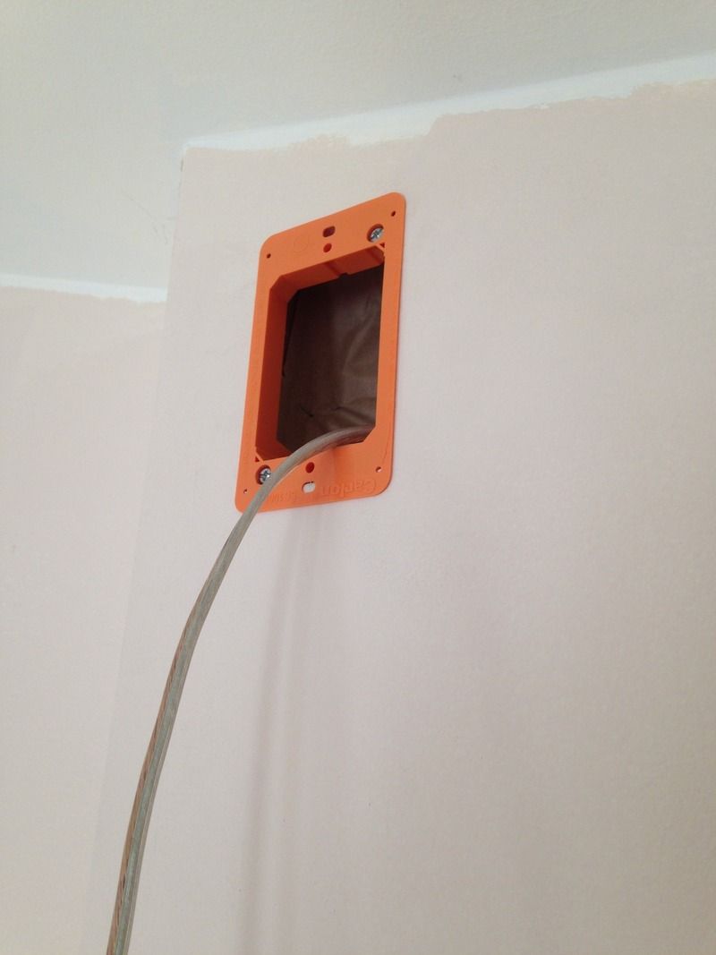

Installed box...pulled wire out...
Speaker done....
